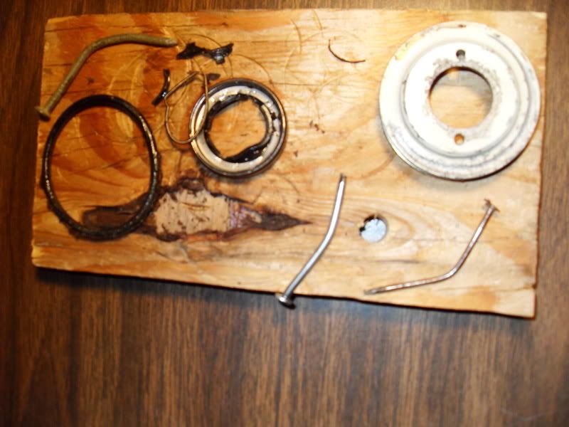

jasper60103
Sep 18, 2008
2,055
Re: removing prop shaft seal
I didn't even have a punch. I did some persuading with a hammer and a few nails.
