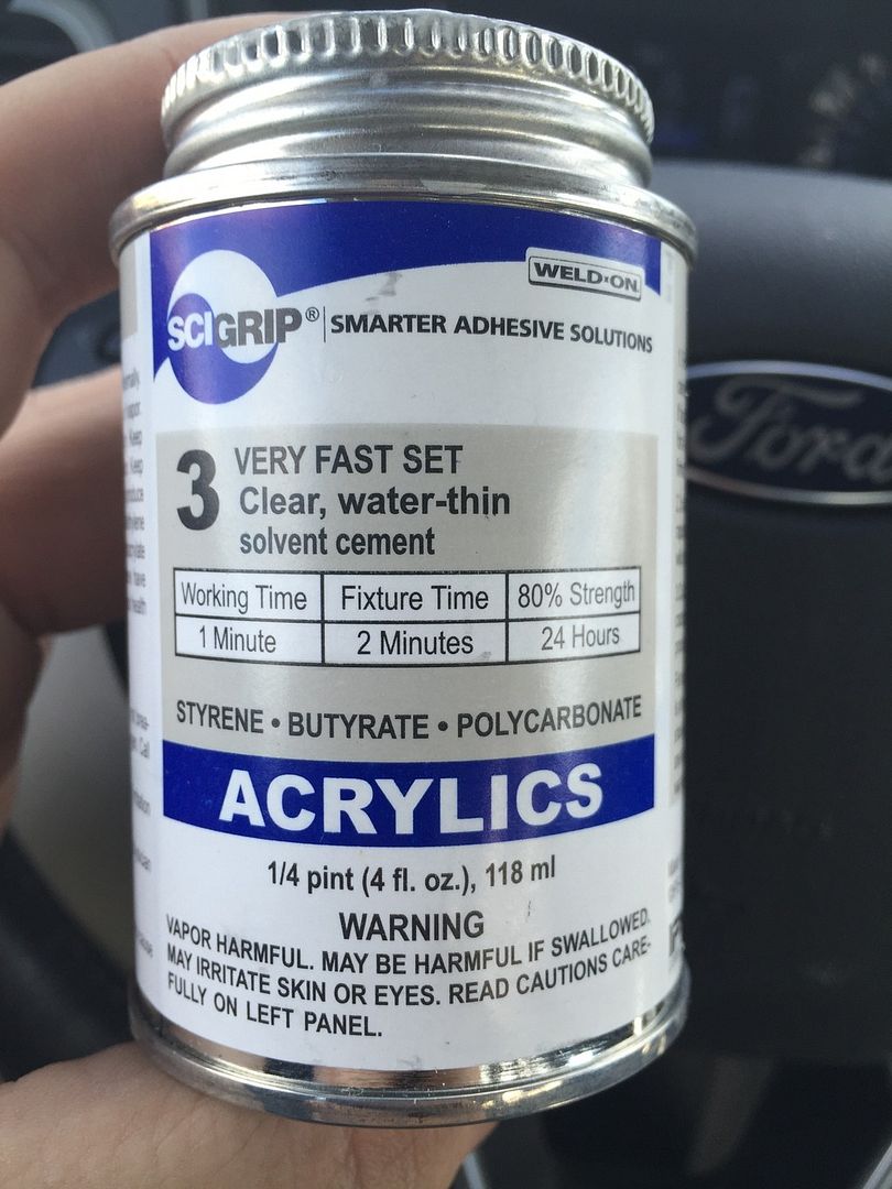

Best thing to use is an acrylic solvent to glue it back together. I have used this in the past for making safety guards from acrylic. Also depending on how the hatch is formed you might find a local plastics shop and see if the can remake the piece. I did this with the companion way hatch and door on mine.
