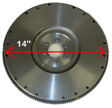

The flywheel that came on th 87 ( omc engine ) won't work with the mercruiser coupler because it isnt drilled and taped for the triangle style coupler I have .. but I can use the flywheel from the 95 mercruiser engine according to Michigan Motors it was the same from 87 on

If your flywheel is not drilled and tapped for the triangular coupler I wonder if the engine is earlier than 87. Typically in a change over year there is a lag in what marine engines are in the assembly que.
Is the '87' flywheel 14" in diameter? if not the older style merc coupler for smaller flywheel bolts to the crank via studs in where the flywheel bolts on.

if the flywheel housing is set up for the 168 tooth flywheel, then yes. the motors are internally balanced which is why the crank changed from the non-balance shaft motors to the balance shaft motors.

the early ( non balance shaft ) Mercruiser flywheel will bolt up to early motor , the problem you could run into as i did is the ring gear teeth being a different pitch , as from what i found there are 2 types of early non balance shaft FWs one is for a geared starter (vortec type) and the other is for the big bulky chevy type..
i am not sure about the harmonic balancer so i used the balancer from the crank and FW as a matched set when i set up the early bottom end. .

no need. a 11" clutch flywheel is 168 tooth, a 10" clutch flywheel is 153 tooth. sometimes incorrectly called a 14" flywheel and 13" flywheel
been that way since the birth of the SBC/BBC all SBC/BBC ring gear pitch has been the same since the beginning as well. copied over from the early in-lines

Both flywheels are the same size and they both came from engines with a 1 piece seal. I do not believe OMC ever had the triangle shaped coupler so I believe ( do not know for a fact ) that this is why its not drilled. and according to Michigan Motors there its the same one but I'm going to call them

OMC did not use the triangle shaped coupler it’s a cylinder shaped one with studs that go into the flywheel/crankshaft and nuts that hold the coupler to the studs. Just like what’s seen on a Volvo SX in fact probably the same part!
I used a PMGR starter to replace the old Delco starter on mine with no issues so I don’t think that there is any difference in the thread pitch. However due to the addition of the balance shaft I always wondered if there was any difference in the flywheels from the pre balance shaft to balance shaft.
