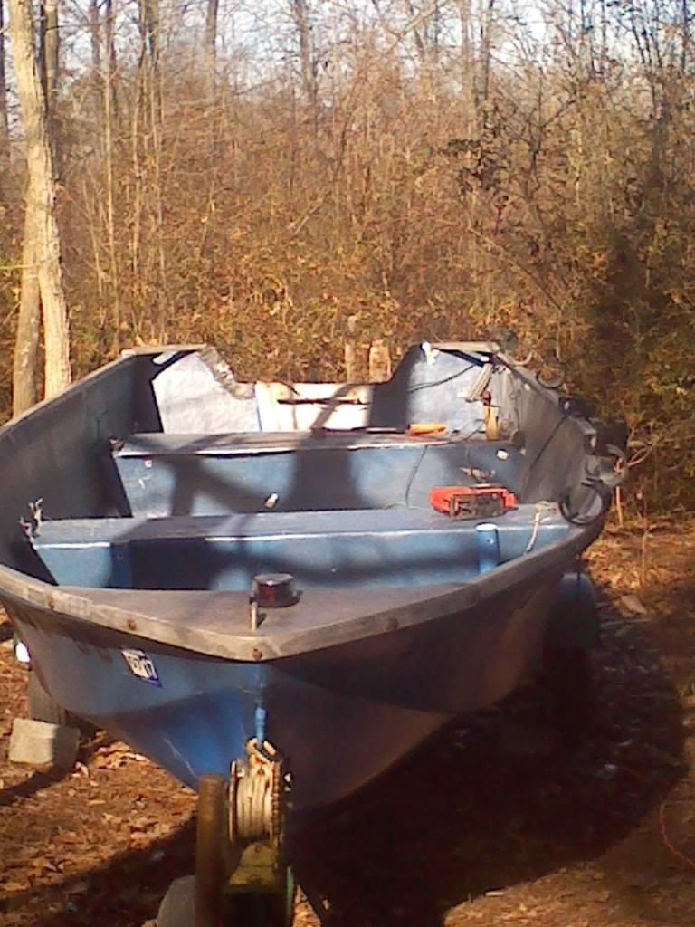

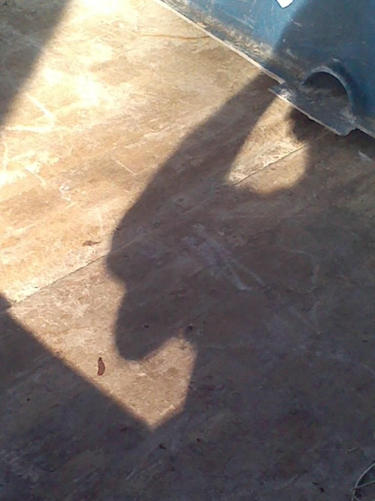

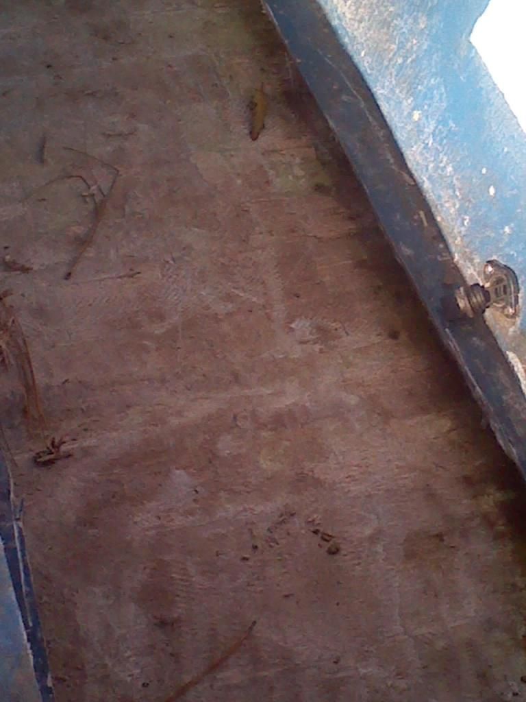

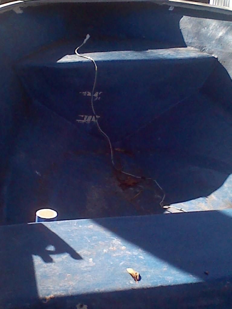

I'm new here. I have a 1960 yellowjacket 14' vhull it like a jon boat layout with 2 bench seats. I got it last spring noticed floor was soft and had crack near side. I was told this boat had no wood all fiberglass. I sanded the crack to find 3/4" gap between2 layers of fiberglass. So i cut top layer of glass out to find it had wood between glass skins. Not just rotted but desentagrated gone. Looks like hard wood floor was laid instead of ply. My questions r what's best way and cheapest way to fix. I'm a poor man...lol

thanks woodonglass! i don't see my type boat...everything i see for 1960 (i got yr from when i registered in all i had was hull number and it came back as 1960) are all wood. mine is fiberglass sides are thin fiberglass like a canoe molded same thickness all over even bottom. laid down wood small 3/4x4x6 inch blocks in a hard wood floor pattern then laid another layer of glass on top.

Yup, you got it now!!! That's NOT the kind of Yellow Jacket I was thinking of!!!:eek: So the wood s 3/4" thick" or 1/4" thick? I'm thinking that's whats known as an endgrain balsa cored hull. If so, that's a PITA restoration. Here's a link that show's what's all involved. It's on a sailboat but the principle is the same.
http://www.westsystem.com/ss/assets/...lacingcore.pdf
Here's another...http://www.fiberglassics.com/fibergl...lacement-guide
and yet another...http://forums.iboats.com/forum/boat-...e-no-stringers
Some other members may come along that's familiar with this boat and be ale to give you some detailed advice. I've never seen one exactly like this before.
