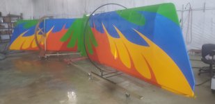

Very funny, quite well. I build and modify aircraft and hot rods as a vocation... im a rookie boat owner, I'm not composite or structures ignorant.... at all. Im one of the few people you'd meet that likes to sand and prep for paint, I also dont mind fiberglass dust from grinding. The lions share of what I do is refinishing. I llove the look on guys faces when they wander into the shop to see their stuff when its finished. A good friend even got emotional. Im happy to have been able to have provided that to him as he passed in March.
Ultimately this job is a no brainer, its just how it has to be, resources are thin. I'm not complaining i'm just getting it done.
What surprised me is the way the stringers were installed, it was a true monocoque structure, when we use wood or foam as structures forms we bond and cover all of it... this wasn't done like that, as a result everything ended up soaked and rotten. There was also no way for the moisture to escape.
it just wasn't protected well, it did last 50 years though. Anyway from what we've seen on other boats even 15 year old boats, this is very common.
These are pictures of one of my "day job" builds.
