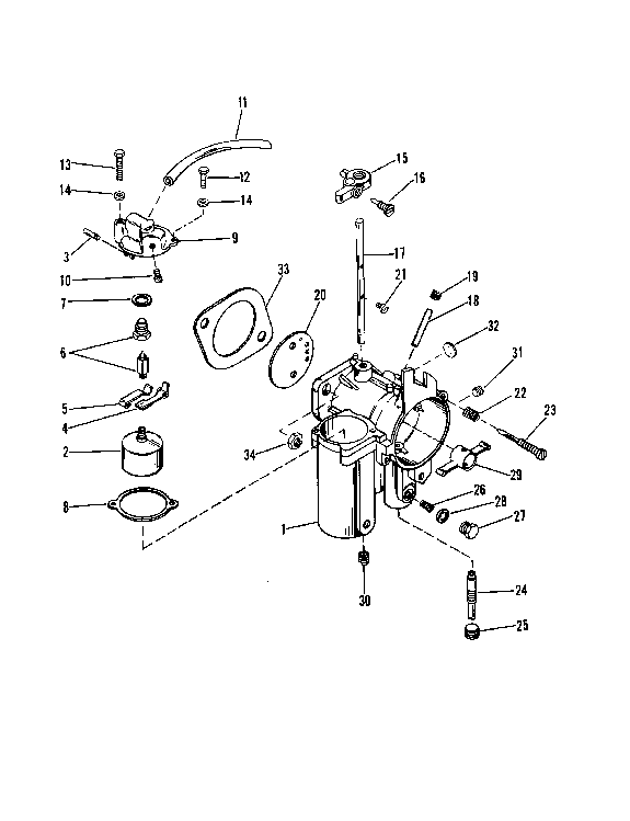

Screw # 25 has a constant drip every 20 to 30 seconds. What can I use to stop this leak, Teflon tape?
I just finished cleaning all 3 carbs and installed items recommended: inlet neddle #6,7,8,33, blew it all out with compressed air.Reinstalled them (3 carbs) and when I pumped the primer bulb gas spray right out of the carbs. So I am in the process of adjusting #4,5 as per the repair manual. Measure 3 x's and hope for the best. Looks like its gonna be an all nighter.
Oh by the way I found a red plastic tube the kind used to attach to an aerosol can behind the middle carb it may have prevented #20 from closing properly.
