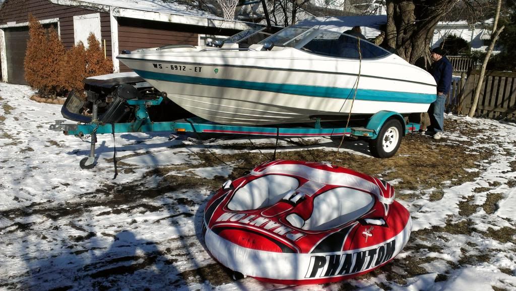

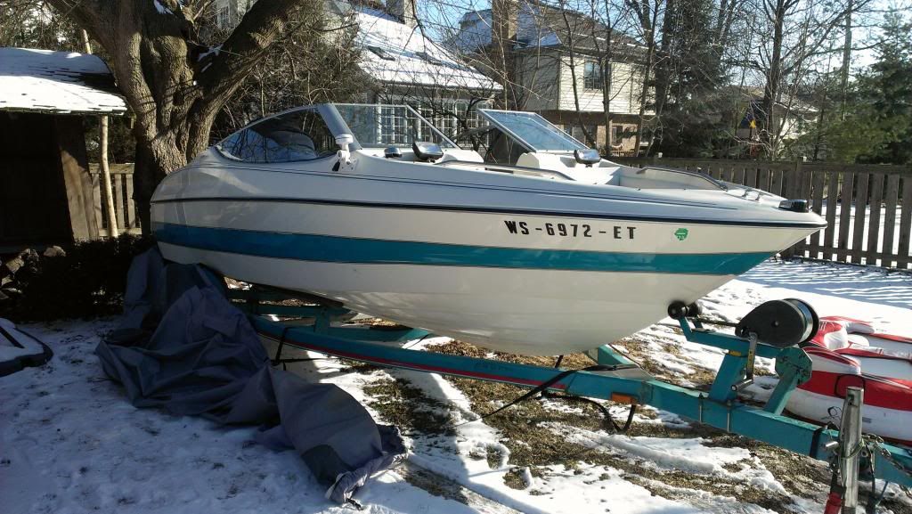

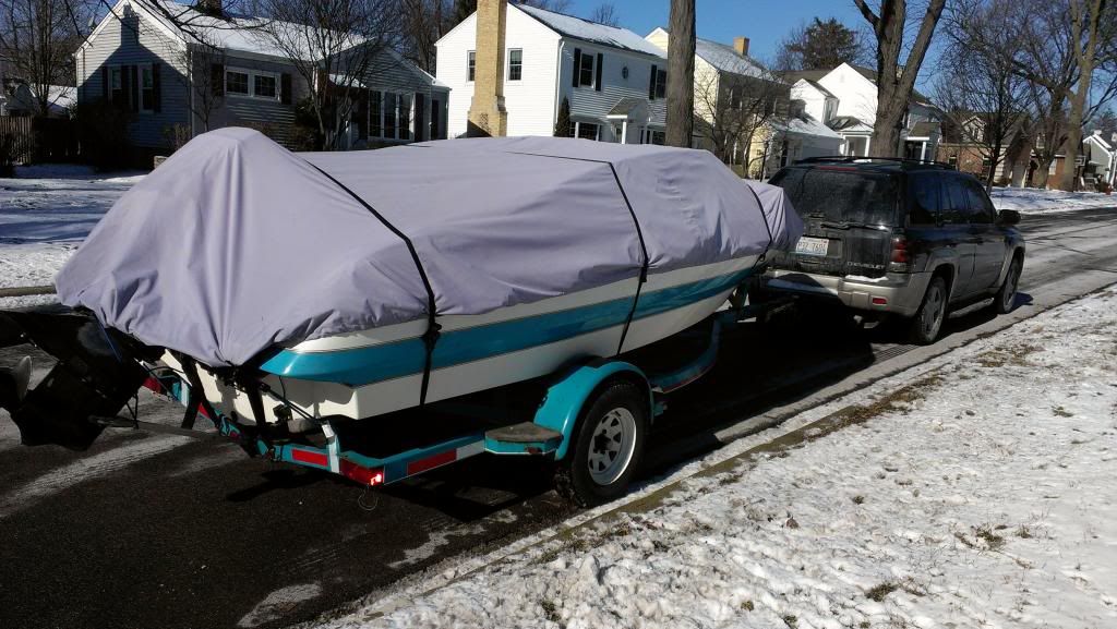

Thank you sir. You helped out alot. I just brought the boat home. (My truck broke down right after. thank god it didnt when i was towing it.) One thing i did forget is to check the lower unit for water. I will though asap. It looks like it was really taken care of. Skeg is broken and the propeller is beat up. I got a new one in the deal. I will weld the skeg together. I knew this before i went to look at it. The little covers in the back are missing and its got a few scraches here and there. Also the seats arent in the best condition but i cannot complain for what i paid for it. Guy seemed legit. Im very happy with the overall purchase. Cant wait for summer. Im going to try to add a few pics.
http://i693.photobucket.com/albums/vv300/bluegixxer1k/IMAG0464_zpseb100999.jpg
http://i693.photobucket.com/albums/vv300/bluegixxer1k/IMAG0473_zpse52f4657.jpg
http://i693.photobucket.com/albums/vv300/bluegixxer1k/IMAG0472_zps01066294.jpg
http://s693.beta.photobucket.com/user/bluegixxer1k/media/IMAG0471_zps82a98fd0.jpg.html
wife seems to enjoy it :)

Looks darn good!
Standard garboard plugs are 1/2" NPT.

Boat looks in pretty good shape. Did you get a chance to run the motor? Make sure it shifted and ran in forward neutral reverse? (that skeg looks like it was hit awful close to the shifting gears) Do a compression test?

Looks real nice. How come she's just settin??? Get the vacuum and put her to work:)
Kidding, my wife laughs when i suggest??? she help clean the boat. says it's my toy and I should take good care of it.
Be carefull if your gonna weld the skeg. The seals and bearing carrier should be removed so the heat doesn't burn them.
Some poeple don't remove the carrier,I do.
