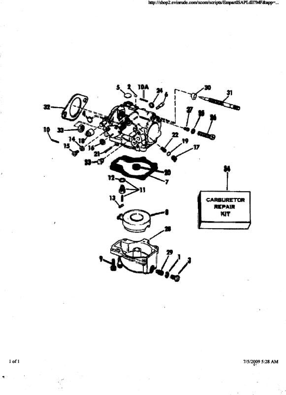

service manual http://www.outboardbooks.com/index.cfm?fuseaction=models.main&year=1983&ID=148986
you also need to use this, for diagrams: http://shop2.evinrude.com/ext/index.aspx?s1=bf6ad09c53cead335fcfd8a6471c0f7f
this is Stevet1984's carb, you can see the difference in the two.
there were 2 versions of this carb, adjustable low speed and fixed jet. Stevet1984's is the fixed jet version, using #25,26,27 not 30, 31 which is adjustable.
