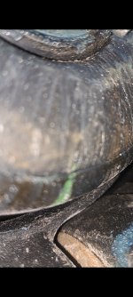

I put the engine in originally with a used OEM Bravo coupler and got this same screeching noise. I put alignment lines with a sharpie on this used coupler and sure enough, the lines were off. The coupler was spinning. When I pulled the engine out, I decided to replace the transom and stringers since there were some bad spots and I figured that was the problem. I rebuilt the transom to 2-1/4" and measured all the parallelism, thickness, flatness, and so on. The stringers were rebuilt solid too. Both engine mount stringers and stringers to the transom. All fiberglassing was rebuilt much better than what was done at the factory. Picture just for your curiosity after fiberglassing and reinstalling transom plate.
