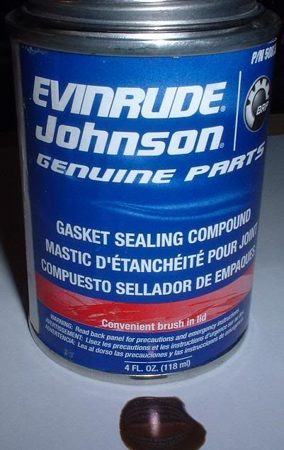

I was told by Evinrude I should use this to seal up my gearcase.
Is this something I'd want to use on the baffle gasket between the exhaust housing and the power head or should I use something else or install it dry?

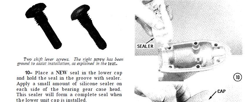

Off on a tangent... one of my manuals says to use a silicone sealer for the gearcase another says to use adhesive M and yet Evinrude sells me a sealer (adhesive M?) which won't dry out much less set up or get hard (although approx. 1/10 oz sample on an aluminum block did thicken to maybe twice the viscosity after a week of air drying).
I hope you can understand why I'm confused.
