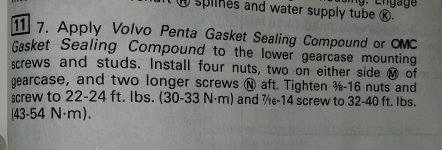

hee's what I found in the service manual.

Thank you very much for looking that up for me. Too bad they don’t list a actual part number for the Volvo sealing compound. If I can’t find the Volvo stuff, I guess I’ll just use a automotive type. Again, Thank you very much for looking that up for me.
