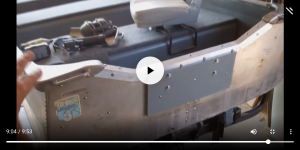

I have searched thread titles, went through build threads. I found a couple ideas on YouTube. And one in another forum.
I've read some posts here where they have a shop make them a new one. And some where they use aluminum channel - even ones where they heat the aluminum and get it follow the curve some transoms have - which looks really cool.
I'm hoping to get other ideas.
Even 'outside the box' ideas.
I need to update my Signature, but mine is a curved one on a 67 aluminum StarCraft.
But I've thought about changing it to just have straight runs and angles like the second pic just so I can do everything with straight pieces and miter cuts.
Thanks in advance.

If you do not need great strength, look at some rubber or thin metal rub rails. They have solid rubber, solid aluminum which can be bent and other options. They attach with SS screws or pop rivets. I think taco is a large manufacturer.

local sheet metal shop, have them bend up a 5052 16 gauge or 14 gauge aluminum cap. soft enough to form with a rubber mallet. strong enough for your needs.

Okay, rubber or vinyl is what I was thinking, but yeah, if I could form some aluminum c-channel to match the Holiday's large arched transom, then I would rather keep the original Holiday transom's curve.
