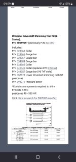

No.... that video will cause someone to crap some gears. OMC housings are precision machined so the only setting you can adjust is pinion height. There is no shimming of forward and reverse gears so any backlash adjust is thru pinion height. Also there is no backlash spec as referred to in video. Pinion height must be set with tool to measurement spec or gears will be short lived. Tool number 5005925

That tool is around $300 if you can find it. Buy a factory manual and all the info you need will be in there

I believe these are what's needed correct?
Part# 393185 omc shimming tool
Part# 339184 omc shimming collar
Part# 339185 omc shimming bar.
I put pictures of them up just in case...not to scale
But I believe tools correct...
Please let me know if I have it right.
Thank you all again.
Sean
Edited for clarity
2nd picture is of universal kit that was recommended by initial Part number.
I can put together the 3 tools for the 40-50hp gearcase for about $140 by themselves.
