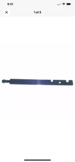

I have this plastic piece tool, I can do it with just this right? What is the 2 piece tool set?
Yes, you can adjust with that, it's designed to be used with the drive installed. Just follow the oem manual for instructions.
The two piece us used with the drive off, the slotted plate is used to control the length of the inner cable at the bell housing. The other part is used to set the dimension of the trunion at the engine end of the cable.
Unknown if there is an aftermarket tool kit available, either borrow from a shop or buy from merc?
