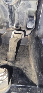

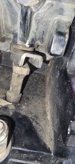

Believe i found out why. First pick is how it is supposed to be. This morning when I went out to check things out, this was the only thing I seen out of place. What would cause this to slip out? It feels like it should be springy cause I was able to put it back in place, and also was able to with 1 finger pull it out of place as well.
There's a washer/spacer in between the cases that likes to escape when they're split. Proper fix is to split the case and replace the washer, the "other" way is to put a hose clamp around the shaft to keep it from dropping back down. That's assuming nothing weird is going on. The drive should still shift by hand. However, if this is a new to you boat, you should 100% replace the impeller before you start using it.

Yeah, you never came out of forward gear before that shaft slipped. Pushing the stick back at that point just gave it throttle.
Thanks. Will take the lower apart over the course of the week and see about getting that done up. And yeah, with lower apart, might as well change impeller and gear oil since I will have to drain anyways. Winter project is to pull the entire outdrive and engine, there is a leak atnthe gasket at theby-pipe and transom.
Ayuh,...... As noted above, there's supposed to be a stainless washer that sits on top of the shift spool, that holds the shift foot up into the shift shoe,.....
