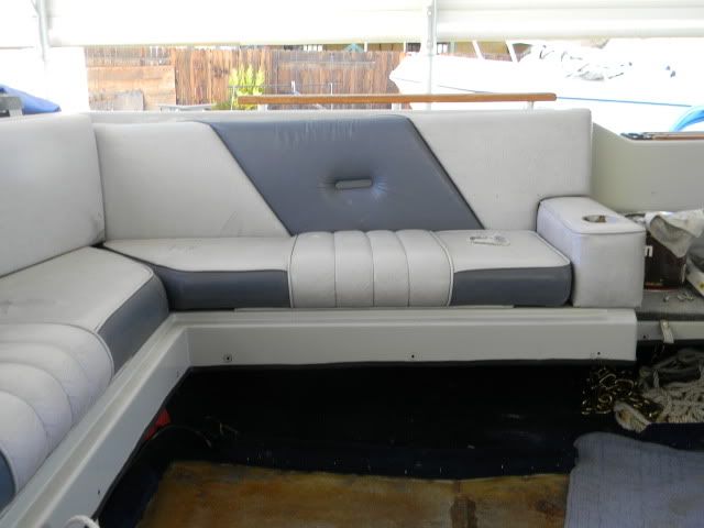

I am redoing side panels for the open bow area. The old has three pieces of foam two different colours will change to one piece of foam and one colour. I think the foam is 2" thick does that sound right doing this because no sewing involed just staple and fold Thanks for any advice the upholstery is original 1986.

You'll need to use 2 layers of something so the vinyl at the plywood edge is not a hard edge, if it's a hard edge the vinyl can get scrapped up easily at the hard spot. On my old boat, I used a layer of foam (3/4"?) on the face of the plywood only, then a layer of batting (3/4"?) on the face of the plywood that wrappedt around the edges to the back of the panels.

Hey thanks for the reply bought three inch foam figured will smash down to 2" when rapping if not can cut to 2". Foam on board sound like good idea have to check on batting not sure what it is.
Here is photo of the panel I am going to trim off the end piece so will be stight on all edges then make a pad to go over arm rest.

duplicating that original look is not as hard as you might think, just add a tufting strap to the seam allowance on the angled seams and that allows you to staple it down then add the other 2 peices of foam and pull all that tight...
the strap I speak of is like this, but in your case you would need one on each seam of the center piece
