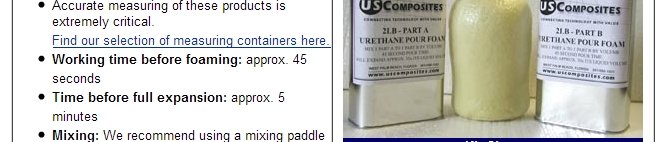

Give this a read, good stuff.

That is the info I was referring to. Especially this part: (pic)
Mine ran the tub over in 15 seconds. Whattamess
This is going into basically 2 rectangular boxes at the rear end of a 16' aluminum v-hull boat. Totally open top to be covered with a carpeted aluminum sheet.
Thanks !
