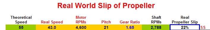

If you have a 1.65:1 gear ratio, your prop slip is 22%.

What exactly is prop slip and how can it be fixed? 22% sounds like a hell of a lot.

While i cannot say for sure but if you will take a look at where your prop but's up against the drive there should be a gap. That is your prop is smaller in dia than your drive. That will create a disturbance in the water flow allowing the prop to cavitate or slip as hwsiii tables have pointed out above..22% is way out there.
