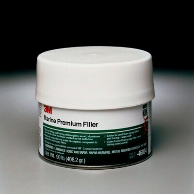

There's two type of fixes for this. Temporary to get you by for a while and permanent 100% correct perfect.
Temp fix. Get some 60 grit paper, sand it all smooth to about a 6 4 inch diameter and feathered out. Wash it real good with acetone, use some 3M High Strength Filler
Sand it smooth. Use some 3m Marine Premium filler to Fair it and sand it smooth with 120 grit. Then Get some gelcoat paste to paint on it, sand that smooth and she'll probabl last you for years.
mediawebserver
The 100% right way would be an inside out repair, but since that would involve removing your deck, I doubt you would be interested in doing that right now.
I'm just sayin...:D
