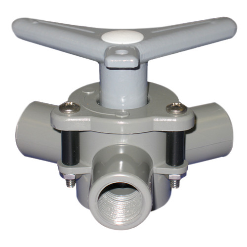

Grub54891
Jun 17, 2012
6,151
If you have the macarater, it has a Y valve to switch from overboard to holding tank. Look for that.
