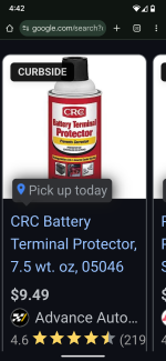

Use batter terminal grease on the battery lugs after you change the wiring
