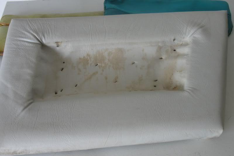

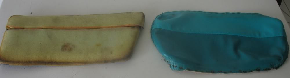

I am doing a very small repair of some cushions. I am looking for the type of foam that is used on panel inserts, the foam appears to be about 3/8" - 5/8". The closest I can find is 1" and while I can cut that down it seems silly to do that if there is a good source to be found.
I have been scouring the web for a source. Any suggestions?
Also, do you have a recommendation on a specific adhesive product to bond that to wood?

Are you looking for an open-cell "cushy" foam (like inside a seat cushion), or a closed-cell "firm" foam (more like wood floor underlayment material)?
Either way, 3M 77 spray adhesive will glue it to wood.

any upholstry supply will sell that foam. you can also look for a furniture repair guy and he should have it

I have bought foam from this place:
http://www.foamforyou.com/Open_Cell_Foam.htm
They will sell whole down to quarter-sheets, or custom cuts.
Their "Standard Medium" foam comes in 1/2", and is a typical 36 ILD (not too soft, not too firm) open-cell polyurethane foam. At only 1/2" thick, I wouldn't go any lower on ILD or it'll feel like a cotton ball.
