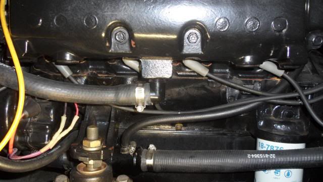

I can not find the spark plugs to change them. Boat won't turn over,been sitting for a couple years.Positive battery cable starts to smoke.I removed distributor cap and traced wires but can not see plugs. Manual does show where

The plugs are up under the exhaust manifold - may be hard to see and access depending upon your boat configuration.

I like a good joke too.If the plugs were visible I would have changed them I would not be asking the question.The distributor wires run under the engine and so thanks I thought that was where they were.

Under the engine??? I'd need to see a picture of that.
Here's where the plugs are on the port side of a 5.0L:

No, the spark plug leads run under the manifolds....

I have owned a chaparral 170hp,this is a Maxum 230 hp V8 1989 . Excellent The pic looks like my engine,yes under not above as in every other engine I have dealt with with over 40 yrs. I do what I can and if I can not I take to someone who can. thanks .

Well since it was either become an acrobat to change the plugs OR so I added new gas and gas treatment,charged new battery. Vaboom engine turned over-every time. I will get plugs out eventually.thanks for the insight.
