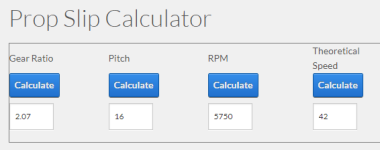

That said, I have talked to another owner of the same boat and model that I have and they are running a 2009 115hp Mercury, and said they reached 42mph. So I believe the hull speed comment is incorrect. 42mph is closer to the estimate Mark gave from the calculator website.

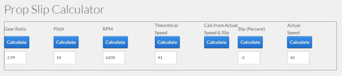

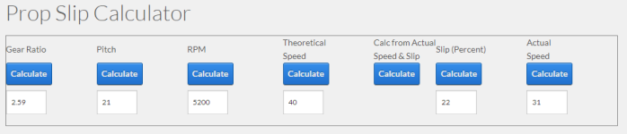

From the suzuki website, the gear ratio on my outboard is 2.59:1.
Putting in actual figures from my experience (21P, 31mph, 5200rpm) it gives me a prop slip of 22%.
Putting in the figures given to me from the dealer's sea trial (19P, 34mph), it gives an rpm of 4894, about 3/4 throttle.
Putting 18P and max rpm (6200) gives a speed of 41, close the anecdotal 42.
Putting info from the mercury owner, I get 16P.

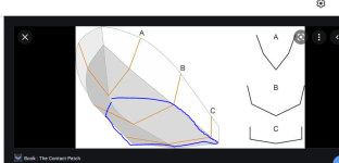

The scale weight new is stated as 1500 lbs. When I've done speed calculators I always use a weight of 2000 lbs. I put the hull type variable at 170 which is in between their value for "average runabout" and "high speed runabout" to achieve 40.7mph.
