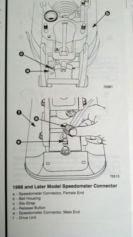

Is the speedometer hose hooked up to the drive? Is the pitot hole in the lower unit plugged up?
Here is from the Bravo service manual

Probably not specifically a Merc issue, but it could be . . . First thing to do is see if the gauge works at all. Remember these are actually air pressure gauges, water jams into the hole in the front of the drive, squeezes air in the tube that runs to the speedo head, air pressures rises as speed increases. If the hose is not connected at the head, or there is a leak somehwere, then no bueno. If you can blow into the hole in the back of the gauge you can see if the needle moves. If it does, then check to see if there is anything jammed into the little hole in the front of the drive (actually look at this first). If the gauge works and the hole is clear, then there is probably a leak in the line that runs from the drive to the speedo head. Or the connector on the drive has come loose or off.
