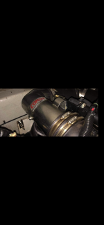

They don't make manifolds or elbows. They pickup after the elbows
I’ve got corsa 90 degree elbows/divertors . If that’s what you mean. You’ll likely be right about the manifold though. Can’t think I’ve seen such a thing, to be fair.

50,396
That is after the factory elbows.
