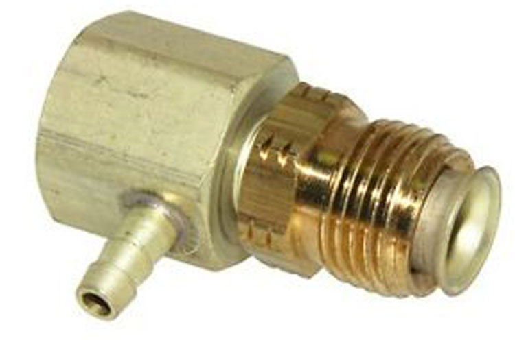

2) Fuel pressure reading is something I have been struggling with. No vacuum valve attachment point on this carb only a pcv going to the manifold. Nothing in the carb manual either about where to attach for readings. Any suggestions?
50,487
fuel/water filter
you dont need a vacuum attachment. you need to get the in-line adapter (per the manual) and plumb between the fuel pump and carb to take a pressure reading.
part number 91-18078
