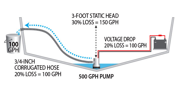

I prefer no leaks but expect it might leak a little… I’ll have a little under 1600 gph capacity factoring in some losses.
