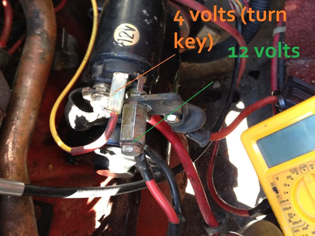

Here are some things I tested today.
the harness to the relay only 4 volts when turning the key for the ignition wire.
Same 4 volts sent to the starter...
I tested the main wiring harness and the ignition wire gets 12 volts there so it has to be something after that.

yeah, its somewhere between where the relay and the main wiring harness. Its hard to tell where since its all in sheath. I might just run a new wire from the harness to the relay.

Here is the wire at the main harness, it reads 12 volts when you turn the ignition as if you were trying to crank over.
