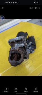

My old started looks like it has seen better days. I ended up buying a Milwaukee M18 mid-torque impact wrench to get the starter bolts off. It took the impact wrench about 10 seconds per bolt. But neither bolt snapped..

Got a leaky exhaust manifold above it? Somehow water is getting to it…might want to correct that or else the same thing could happen to the new one….

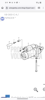

So I found something odd with old and new starter. The battery cable lug is not on a stud on the solenoid held by a nut.
Rather a metal spacer is screwed to the stud and the battery cable lug is held tight to the spacer with a bolt. The spacer and the bolt are grabbed by a magnet so steel. The spacer looks a little rusty on the outside the inside threads looked yellow tinge.
So 100% of the starting current goes through the spacer which is steel and not a great conductor of electricity.
This spacer appears in the Volvo Penta parts list. It's possible the VP spacer that was screwed to the starter when it shipped from the factory could have been different. Maybe copper or copper plated? #6 in diagram.

I could be wrong but it almost looks like you can use the spacer or use the more typical nut (pn#5) that goes on the stud. Maybe some of the newer engines have a different wiring harness that requires extra clearance?
I think #5 is a small nut to hold a small gauge wire ring connector from the key switch into a smaller stud.
I am still trying to figure things out with the old starter. The old starter solenoid had the stud for the battery cable broken off with less than 1/4" of thread sticking out of the solenoid housing. I think someone tried to remove the spacer and it snapped the stud. So they went to a hardware store and got a threaded steel spacer. It just fit the 1/4" of the thread that was left.
I will bet the Volvo Penta ORM spacer is copper and not steel. I have a steel spacer because the previous owner bought it at a hardware store.

Yep you’re right I didn’t look closely enough.

So I got a VP OEM part #5 online and it sticks to a magnet so it steel. So 100% of the starter current is going through a steel spacer. Does not seem proper.

Could you just use the normal nut on the starter solenoid stud? Not seeing why there is a need for a spacer unless something is mounted on the engine that interferes with the normal mounting.
I am not sure. But it's in the VP parts diagram. VP does not cut corners from what I can see.
