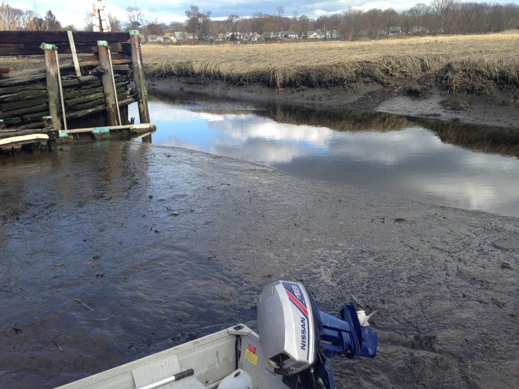

A "mud slip" is a dock/boat slip that when at low tide (in a tidal area) their is no water at the dock. The boat would sit on the mud for a couple hours until the tide comes in. In my area, theirs a 6-8ft tide height. So at high tide it's 6-8 ft deep at my dock. At low tide the boat is on the mud or bottom. I will post a pic of the dock at high and low tide.

Yeah, I would want an outboard I could take all the way out of the water or mud. Basically something that didn't touch the mud when the boat is sitting on the bottom.

You need a boat lift. No way MY boat would sit in the mud.

I'd think outboard as well. Not that you're actually pursuing it, but I don't think you'd actually want a jet boat if it's going to land on the mud and sit there until the tide comes in. You'd end up with all that gunk up inside your jet pump and over time it would wear on things and cause cavitation.

After seeing this pic, I would say no to a stern drive and a jet intake which is on the bottom of the boat for a no, OB is the only way to go with that mud slip.

'Mud Slip' what you have there is something that I would not even let my rotted boat sit on.

MAYBE what you need to do is build your own "boat lift" Just a set of pilings with crossmembers and bunks.... at high tide the boa would float above the bunks inside the pilings and at low tide it would settle on the bunks a foot above the mud... OR a similar system between two floating docks that had structure which would settle on the bottom supporting the boat again above the mud.
