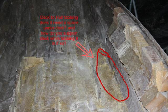

Hope this is not considered hijacking but I think it is a relavant question when replacing stringers.
Question:
Does the deck need to be kept off the hull the same as the stringers?

Trooper, the deck is supported by the stringers and does not need to be lifted off of them at all. In addition, there will be a gap between the sidewall of the hull and the deck, filled with PB

Ok Zak, i was thinking the farthest edges of the deck where it meets the hull would also need to be suspended. If this was the case then stringers would be the way it is lifted.
I wonder about this as well...my deck seemed to be supported by the hull at the port/starboard edges...

the deck sits on the stringers or frames......the out side edge of the deck.... kinda sits in space as it reaches to the outside edge of the hull......
then we add peanut butter in the slight gap between the hull and deck......then ....layers of csm and 1708 tabbing hold the deck to the hull.
when its done....you can stomp, jump and hammer on the deck ....no worries....
dont worry about a hard joint in the deck hull edge....(if the deck touches the hull) it is of little conncern.....the closer you can get to the hull...the better....if you can make it touch, and fit......like a countersunk screw......all the better.

+1 ^^^^ I was somewhat worried myself I had always assumed it rod on the hull, in like 2 places the hull was foam-free because the deck was "touching it", that makes me feel a little more confident! just when I think I got it figured out, something makes me question myself lol
