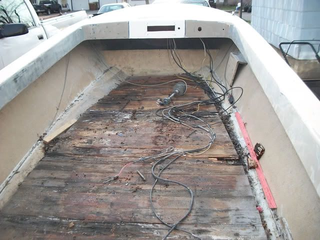

Here's the Deck of the boat.
The top layer is 1/4 plywood.
I removed the 1/4 inch plywood and found 1/2 tongue and groove wooden boards.
After I removed the the tongue and groove boards I found the actual deck of the boat and a big hole.
I cut the fiberglass, Just under the fiberglass was about 1/2 plywood that sits on the stringers.

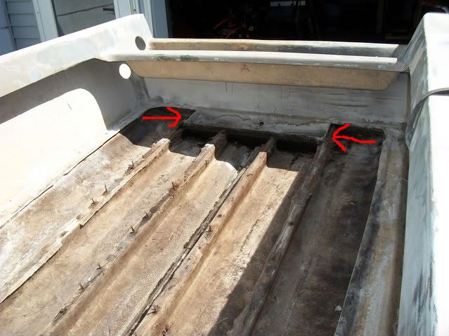

Now, On the outer stringers, there were holes drilled through the fiberglass and stringers into the bilge. I dont know if this was done by someone in the past or the way it should be. The holes were drilled in the location as marked in red arrows.
Should those holes be there when I put the stringers back. Or when I put the stringers back should I seal it up?

I installed drains in my stringers on my boat too. They will help in drying.

I might add, the holes there were in the stringers weren't fiberglassed. you could feel the rotted wood.

Ok Buzz,
Now you're talkin!!! WOW Three layers of Decking. What a mess. I guess the PO's were just to lazy to fix it right. Well at least you are going to. YES YES YES make sure to keep the holes there. They are needed for draining any water that can and will get under the deck. Make sure to grind the old fiberglass down for good adhesion with the new glass and encase your stringers in fiberglass resin and cloth and seal everything below deck as best you can. Check out this guys thread. It has a LOT of great info on how to do what you are going to be doing.
