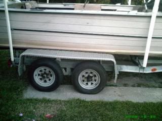

Heres my before..
And after..just sanded, cleaned of the dust and rolled rustoleum
