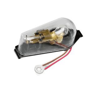

Wesbar makes a light with a sealed module inside.
Had them on a trailer a while back.
Replacements were a little hard to find locally.
Here's a pic of the module.
Been using Wesbar and Peterson LED's for a couple years now. Had some optronic led's, but they failed miserably (2 sets).
