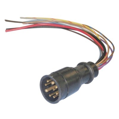

A few pins that came off of the male part of the harness and are now stuck in the female end, can they be removed and then be put back into place on the male end, if so do I just push them back in? And would I need an adhesive or solder them in back into the male end? Please advise, Thanks 👍
alldodge
Mar 8, 2009
42,622
12V power is there but the Tan wire going back to sender is missing.
So far as the pins you have a few options
Carefully pull pin out and try to get it started in location, then carefully push back together
Remove pins totally from both connectors, solder together and reinstall rest of the connector
Get a new male pigtail and splice all wires from old to new. Link below is Hardin marine but think if you look around you can find cheaper or even used out of another boat
https://www.hardin-marine.com/p-132...-pigtail-mercury-plug-instrument-side-12.aspx
