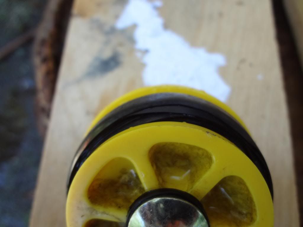

In order to isolate the exhaust and water sides of the manifold/elbows you first have to plug the center exhaust hole in the elbow. This hole has a diameter of approximately 2 1/8"-2 1/4" which turns out to be very close to the size of a 2" PVC sewage pipe.

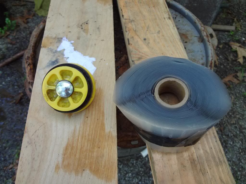

Since the exhaust elbow opening is at a slight angle, a 2" expandable PVC pipe plug will not seal off the the exhaust hole. In order to increase the diameter of the plug, you need to wrap it with some 1/2" self fusing silicone tape.
The plug will now seal off the center exhaust port.

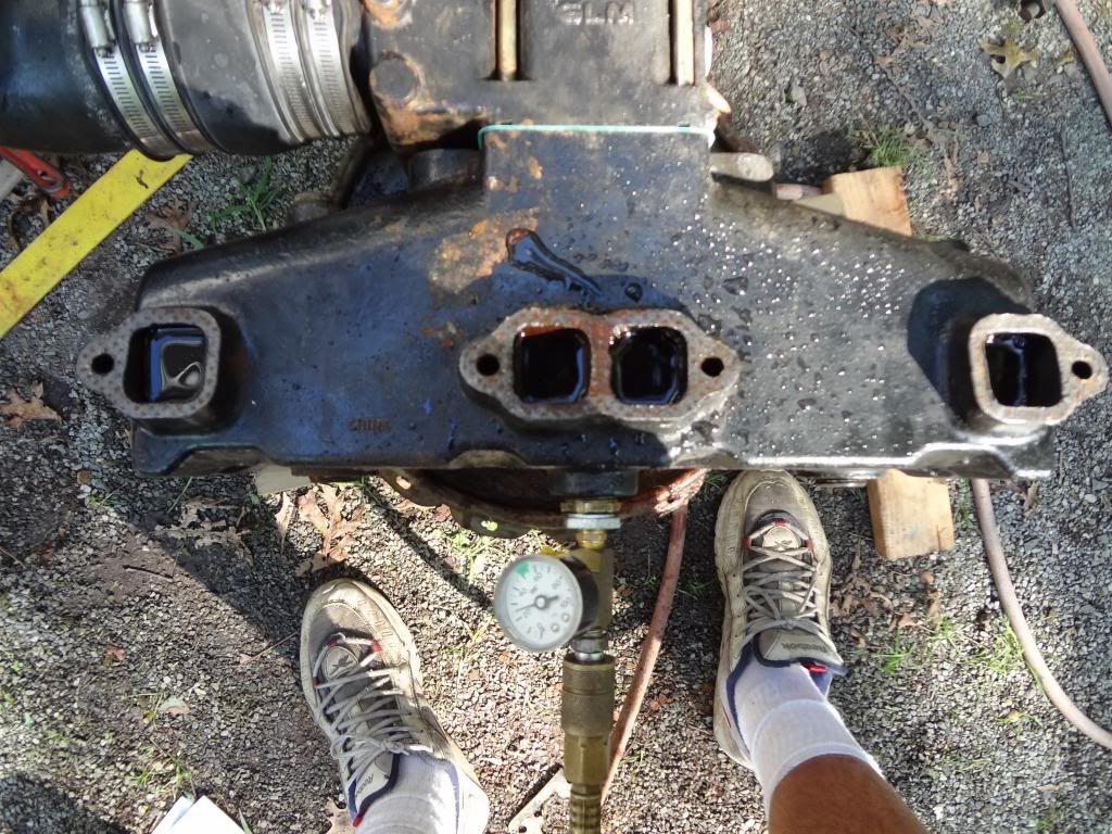

Now lay the manifold/riser/elbow flat on its back so the the block exhaust manifold ports are pointing up and fill the exhaust ports with water and verify that no water is leaking out of the plugged center exhaust hole in the elbow.
You now have to plug the water side of the elbow. I did this my cutting a 3/4" piece of scrap plastic to plug the rubber exhaust sleeve.

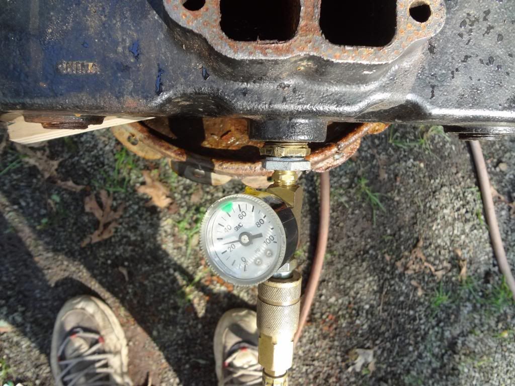

I had to plug the Y pipe portion of the rubber sleeve due to elbow center exhaust clearance issues. You now apply air pressure to the water inlet port on the bottom of the manifold
if you don't see any bubbles coming from the water in the exhaust manifold ports or any hissing of escaping air your setup is sound.

  1. Expandable 2" PVC sewage pipe plug (Several dollars at your local plumbing supply store)
  2. Several feet of 1/2" self fusing silicone tape.
  3. 3/4" NPT to 1/4" NPT bushing if connecting directly to the manifold or a rubber hose and barb adapter.
  4. 1/4" NPT pressure gauge.
  5. 1/4" NPT Tee.
  6. 1/4" NPT valve.
  7. 1/4" NPT close nipple.
  8. 1/4" NPT air nipple.

  1. Smooth out the inside of the output side of the exhaust hole in the elbow so that the 2" PVC plug will be able to "seat" nicely. I used a 1/4" straight carbide de-burring tool in a high speed grinder to accomplish this. It doesn't have to be perfect. You can verify the seal when you fill the manifold with water.
  2. Add the 1/2" self fusing silicone tape around the rubber gasket on the PVC plug in order to increase it's diameter. When using self fusing silicone tape you usually stretch the tape at least 50% in order to get the tape to fuse to itself better. With this application you want to use the stretch of the tape to plug the hole as the plug is expanded so you want minimize the stretch applied when the tape is installed. I used maybe a 20% stretch when applying the tape. Test the fit in the exhaust elbow.
  3. Install the PVC plug and tighten it down. I used a wrench so ensure it didn't leak.
  4. Fill the exhaust ports of the manifold with water. Make sure that the exhaust ports are the highest point on the unit. Tilt the manifold/elbow unit in order to make sure there is not trapped air in the unit.
  5. Verify that no is water leaking from the elbow center exhaust PVC plug.

  8. Create the air pressure delivery apparatus.
  9. Attach the air pressure delivery apparatus to the bottom of the exhaust manifold port.
  10. Pressurize the exhaust manifold water jacket. Since the pressurized system includes the rubber sleeves, be careful not to over pressure the manifold. I went a high as 25 PSI and you can see the rubber sleeves bulging. If you have an old set of rubber sleeves it might be a good idea to use them so you don't put undo stress on your operational sleeves.
  11. If you hear hissing coming from the rubber sleeves or the sleeve plug just tighten them until the hissing stops.
  12. Now look for any bubbles in the exhaust ports. If you don't see any bubbles after 15 mins you're setup is sound. You can also close the air valve and see if the pressure decreases over time, but when I was testing I could see also immediately whether there was a leak or not.
