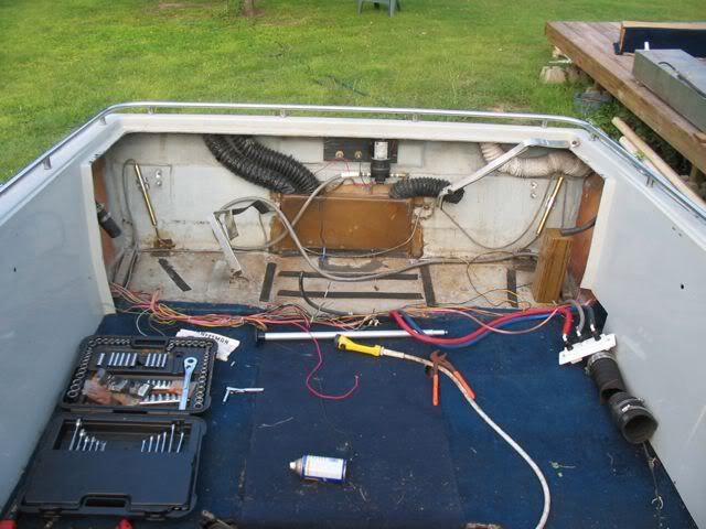

After tinkering for a few hours today, the engine is out. Pulled out really nice too - My hoist pulled it out w/o any problems at all. I just raised the bow and had tons of clearance.
Thanks to all who helped w/ their advice! Hopefully next weekend I can be installing the new engine and get back on the freakin' lake!:D:D:D

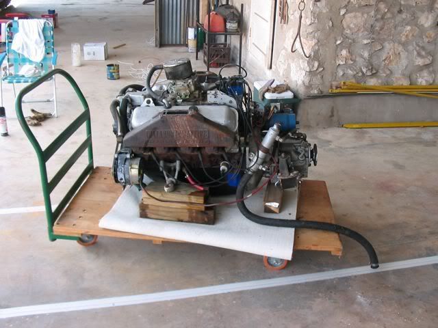

Re: The engine is OUT!!!! WOOT!!
Pics:
and
It was really not that bad, especially compared to a car!

Good job! It is amazing how easy it is to pull one considering the anxiety that comes before doing it. BTW, now is a great time to clean and paint your bilge!

AFAIK, my hoist is a standard automotive style one; $250 at any local parts store.
I had it set on 1/2 ton, so it would extend as far as it could.
I lifted it and swung it over the side of the boat. I think the reason it went so well was the fact that the head and valve cover were off; ie. I could get the chains lower on the block because I didn't have the extra height of the cylinder head, etc.
