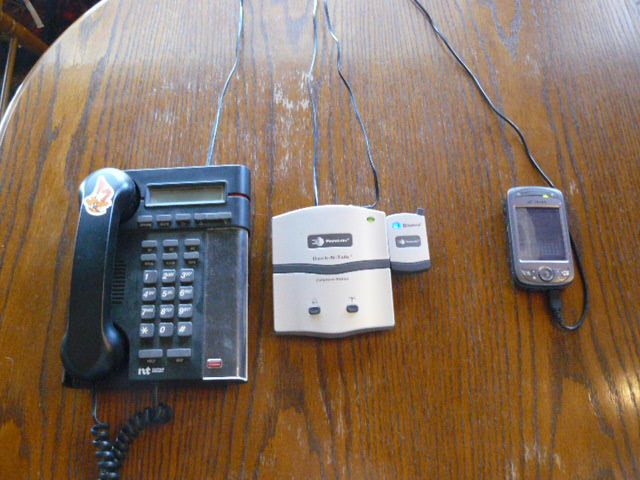

As a few guys have been saying, their cell calls keep getting dropped due to lousy reception in their area.
And since I only get good reception out the back of the house I bought this dockntalk unit for remoting my cell phone to an analog phone (POTS) pick up the phone, get a dial tone, dial the number, cell picks up and dials out.
For incoming calls just pick up the handset.

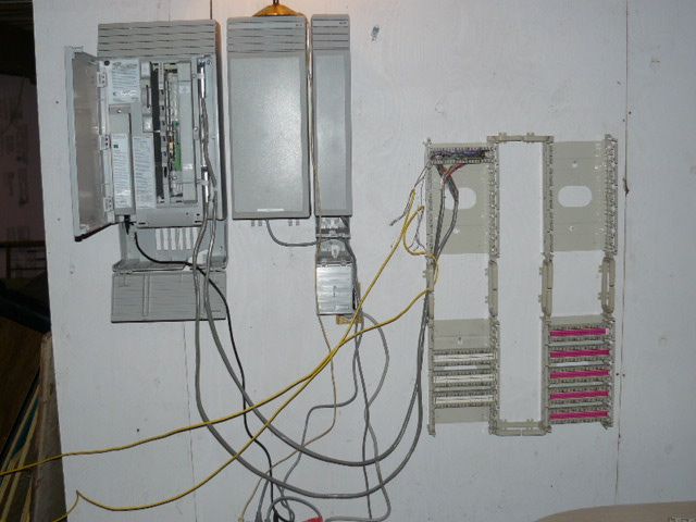

And whats better is that I can terminate it into the switch in pic#2 to give me a 2 line business phone system.

OK, in a nut shell.
The dockntalk turns the cell phone into a home phone like in the picture, it does what the home phone will do, lift up the hand set get dial tone and dial out, cell phone acts like the incoming/outgoing line.
(its blue tooth)
Now the second pic is of a business switch, I jumper wire to the blocks on the right of it instead of to a telephone and it gives the switch a second line to use.
