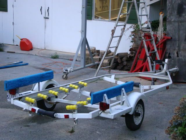

The trailer in the picture below was sandblasted, primed and painted with Rustoleum Rust Stop paint. I did the whole thing out of a can......12 years ago. That's right 12! Up until about 4 years ago it was used virtually every weekend. It has allot of problems now and it needs to be repainted. But I have to tell you for a spray can job, this paint lasted a long, long time. I have to think that a higher quality Rustoleum would even go longer and look better over time. I used a cheap sandblasting pot and spray cans. As I remember it took about $150 worth of paint. When I do it again, after I finish my boat, I am going to use Rustoleum again. But this time I will be using a Spray gun. Good stuff.
