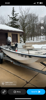

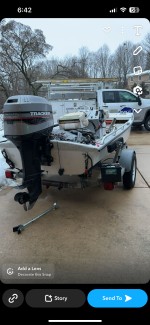

I actually picked up this other boat kinda similar except there’s no wood on it. At least that I’m aware off. The whole transom is fiberglass. Everything looks to be fiberglass. Unless I’m wrong…

Transom is wood
Hull is foam core
Weigh the boat. Most foam core boats are waterlogged
If it’s wood then it’s solid because this transom doesn’t budge. And if it’s wood then it’s completely incased in the fiberglass. I’m not dropping anywhere close to 2k on that other boat I paid $1700 bucks for. So that one’s getting trashed. Sucks. I loved that other boat.
