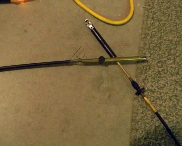

Re: Transom shift cable question Update
OK pulled outdrive ordered transom shift cable figured that had to be it. But it was the control box shift cable did not order that one:mad: I should have and will check all cables next time I have a problem. So no boating this weekend.:facepalm:
I will order now. Remember check all cables when having shifting problems....
Two years ago I changed the controller and all cables. shifted like butter. But I guess the one cable was faultey
