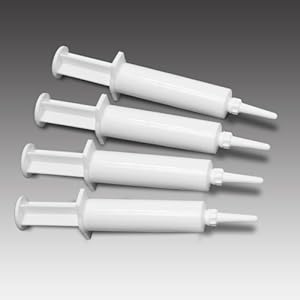

Ditto on this ^^^ Amazon sells the Glue syringes...

I am planing on using a catheter syringe to do the deed.
It is free.
