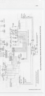

After sleeping on it and doing a little more research I may have a solution
I am assuming(I know the saying) that I should hook up the trim sender the way the manual shows and leave the wires coming from the switch unhooked. Looking at the wire and hydraulic schematics it should work
Does this seem like a reasonable assumption?
Thank you.
