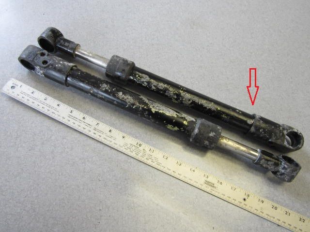

my trim ram cylinders just started leaking fluid (yay!) but not from a spot i would have expected it to. are these rebuildable? or do i need to buy all new cylinders?
would a new seal kit fix this problem??
the picture shows where it started leaking..

Ayuh,... I don't think they come apart at that point, or ain't supposed to, so a new ram housin' is in order...
The only 1s I've rebuilt, ya pull the gland nut off, 'n unload the guts outa the tube...
The tube is supposed to be a single piece...

The parts are called out as separate items, but are not sold separately... They come as a single entity in the 'Tube kit', part# -45706A4 (supersedes to -77442A1), which is not cheap (from Merc), but can be found here -> Power Trim Cylinder Housing for Mercruiser 77442A1, GLM 21930 - Sierra 18-2148 - iboats. for a very reasonable price.
BTW, yours are GTG... and need to be replaces...
Personally, I'd just buy a couple of complete new rams. Getting those apart could prove 'challenging'... Getting them back together with a leak, more so...
Complete ram -> Power Trim Cylinder - Sierra - iboats
Chris.........

SEI has replacements for $120 a piece.

i would love to get the SEI but i dont see a listing for the old mc-1??? as far as i have read the alpha 1 gen 1 and the mc-1 rams are not interchangeable can someone confirm this?

Doesn't look like they do them for the MC-1 (internal lines) ram. Look like you're stuck with the iBoats/Sierra ones.... The only ones interchangeable are the external lines ram, and you''ll need new hoses for them, which will probably cost you more than the rams...
