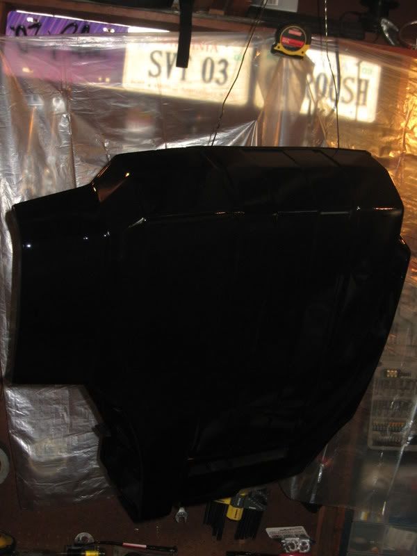

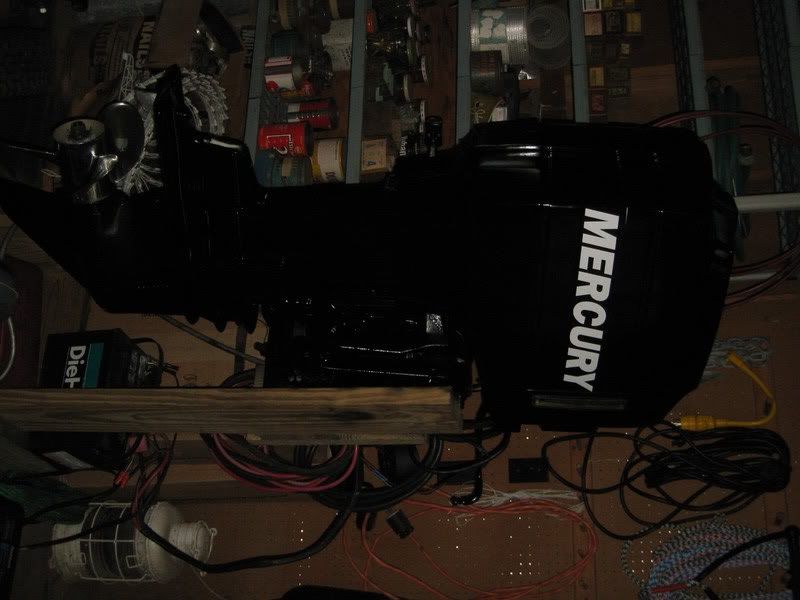

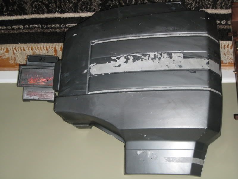

BEFORE:
AFTER:
I have the MERCURY decals that I cut yesterday - I will probably put them on tomorrow..
I sanded everything down with 220 grit paper on an orbital sander, got the nooks and crannies with paper in hand, cleaned off with a chemical of which I can not for the life of me remember the name. I then put on about 4 coats of the MERCURY "Phantom Black", then followed with a coat of clear (just on the cowls). I'm pretty happy with the results.

shep, that looks sweet. nice job. what kind of clear coat did you use?
SHEP#1
Nov 10, 2007
14
Re: updating an outboard motor
Thanks! I don't have the cans anymore, but I do recall that it was made for painting rims/wheels on cars. It claimed a "protective" barier against rocks and such.
tallcanadian
Sep 7, 2006
3,250
wow, that's awesome. tall dark and handsome on the transom!
