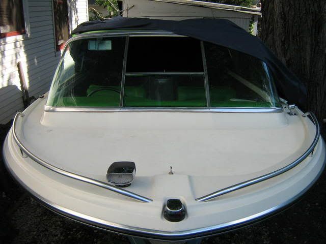

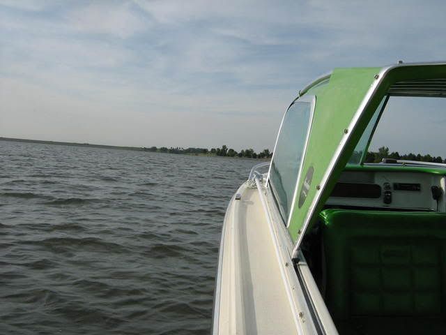

don't know if these will help yfz. but here ya go...
if ya look close, ya can see my antenne laying on the gunnel. i was lucky. i got flat top walk around gunnels. made for an easy mounting...
mounting point was just behind the windshield.
i used ss fender washers to back up the bolts... think i used 1/4-20 ss bolts.
i saw no other good options for install on my boat...
