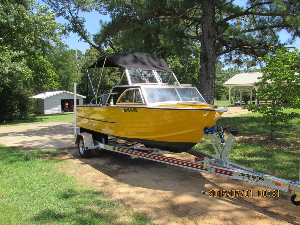

I have a 1972 Starcraft Starchief 18 ft cuddy and the plexiglass cabin windshield is in bad shape. I see some restored craft of the same model with new replacements that look excellent. Are these from some aftermarket, Starcraft manufacturer or locally made?

If flat replace with actual glass not plex . Is the frame in good shape?
50,426
many plastic companies make boat window replacements out of acrylic
Watermann
Jan 12, 2013
13,822
For my Chief I had a glass shop cut and put the center bend in mine out of poly carbonate, just remove the old one and take it to them so they can get it right. Don't remove the protective film from it until you have it in place for the install.
