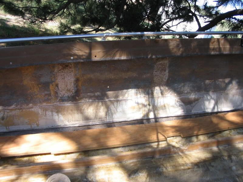

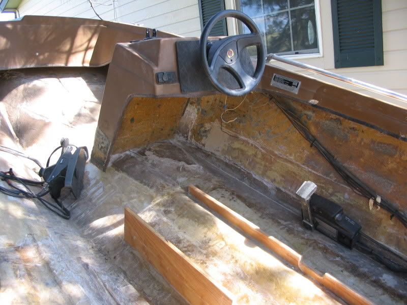

Thanks alot...<br />1) Does it take a flooring roller to lay the flooring down using this method? <br />2) Do you apply the contact cement to bothe the back side of the vinyl and the floor, or is it sufficient to apply it to just the floor and then roll out the flooring?<br />3) If I was to paint the inner side of the hull on the sides (with maybe bed liner) and build some panels to go from the floor to the cap, could I use 1/4" hardboard covered with upholstery vinyl glued to it? I'm not sure how sturdy the panel would need to be.<br />4) Where do I find medium reducer....I'm not familiar with it...<br /><br />I would not have ever started this project without this forum to research. Thanks to all of you for your help. Here is a picture of my side with my new stringers going in...<br /><br />
http://i58.photobucket.com/albums/g242/dbergman303/Boat/IMG_0371.jpg

No roller dbergman, spray both the vinyl and the floor and let it tack up. Re-read my post, it gives good instruction. It would help to have someone hold up your folded vinyl straight up in the air while you begin to push each 24" glued section down onto the floor from the center, then work your hands to the outside edges. Your helper would be lowering the vinyl as you call for it so you can control the contact and eliminate any bubbles in the vinyl. Remember that it is contact cement so have your material lined up b4 you begin to unfold and press it down.<br /><br />Get the medium reducer at any auto paint store,<br /><br />Your other questions I have no opinion on as I am packing for a trip to California.<br /><br />Looks like you are a ways from laying flooring yet. Be sure to clean the blush of the epoxy floor coating off with acetone b4 you begin to glue.<br /><br />If you look at my picture you will see that the sides pockets are also covered in Nautolex. It is the original material which I will eventually pull off and replace with the new stuff that is on my floor. Just fit and precut the side pieces and glue them in the same way.
