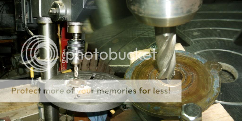

I have an 1985 Bayliner With an AQ125B 2.1 liter engine. I replaced the inner seal for this water pump and it is still leaking. Any suggestions?![]()
$3.00 part and not hard to install when you learn the trick for getting the one out of the brass pump cover.
